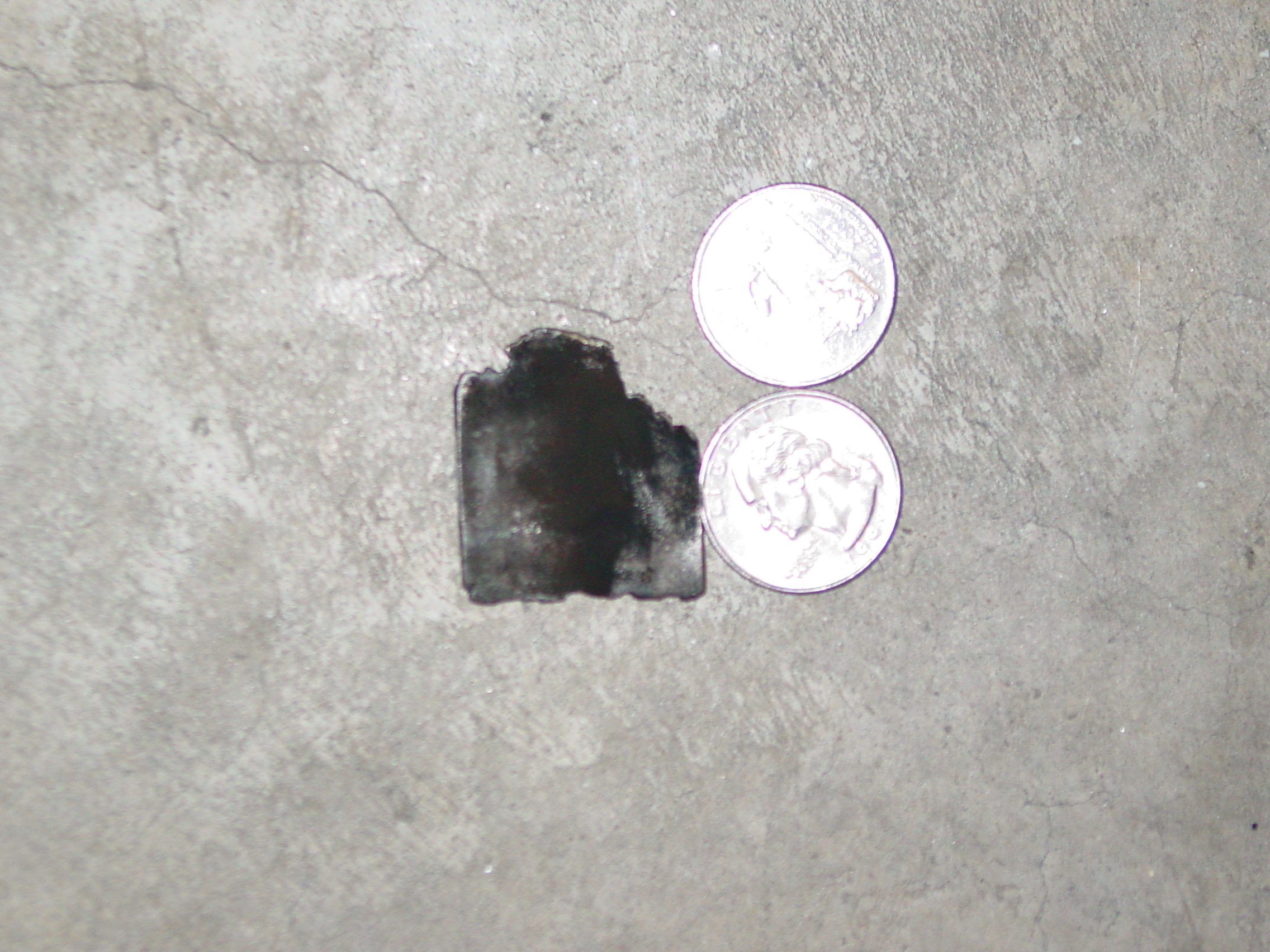

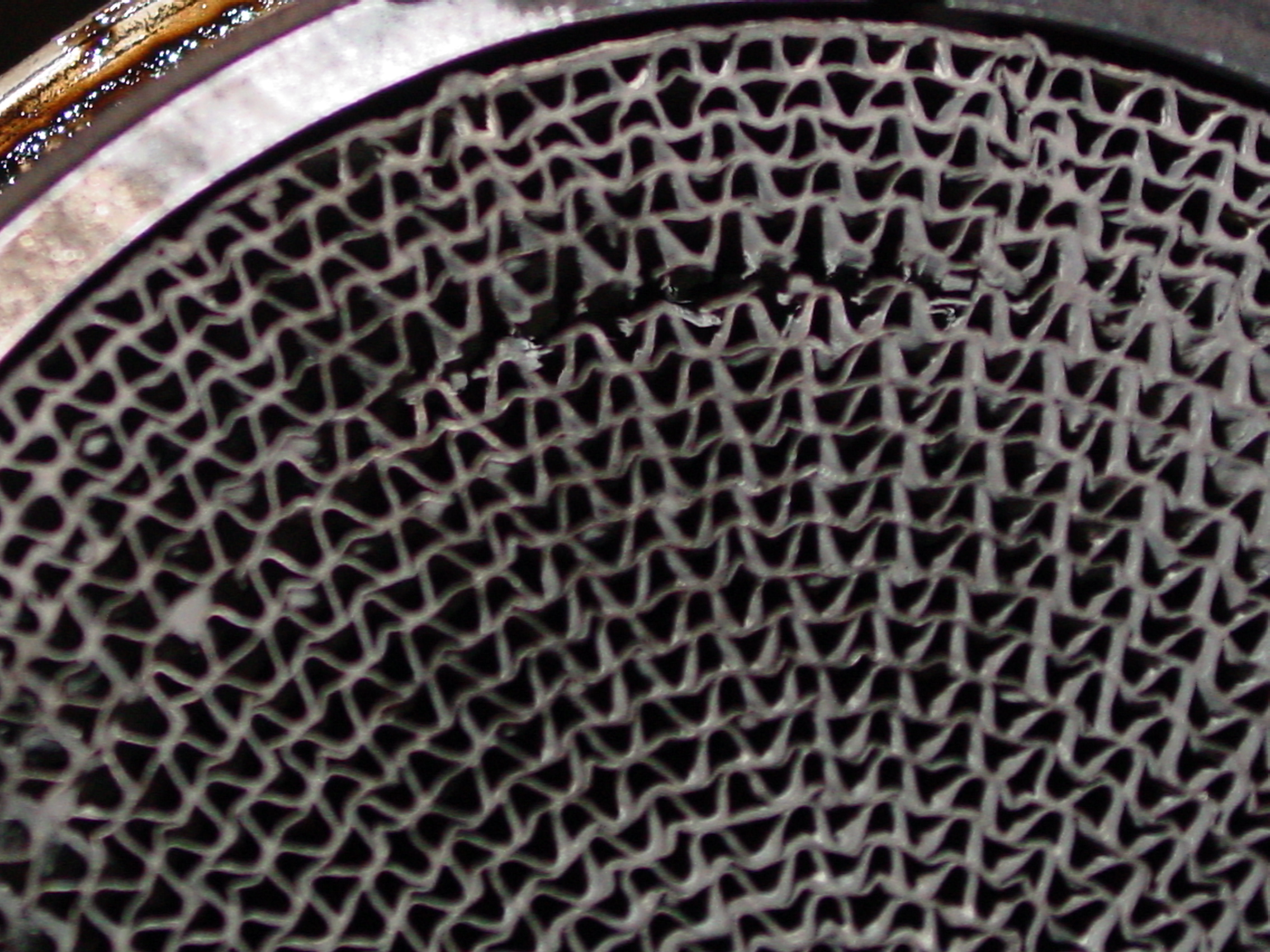

                      All carbs are spotless. After inspection of the carbs I was still stumbled so I took the exhaust apart to further inspect the catcon. The cat con is loose in the housing should it be tight? I also found a piece of metal almost the size of two quarters inside. There is a portion of the catcon that is starting to separate as well. May have found the problem, however, now im wodering where the metal came from. Did not check the powervalve and the reed valves are good? Suggestions? Thanks.

                          the information is accurate, again, this is new for me. I looked into the exhaust to look at the "cat" upon first inspection, after actually tearing into it i found this. Carbs are clean, reed valves are good. Cat looks like the picture listed and as stated it is loose within its housing. Should it be? Any suggestions on where the metal may have come from? Thanks
                          • #14
                            Re: 2001 xlt 1200 hesitating
                            Those carbs have anti-tamper caps on the high and low speed needles. No need to adjust them if you are staying stock. You have to drill the caps out and install t-handles if you want to mess with the tuning. Check your needle and seat. Look for a ring aroud the tip of the needle (worn). I would replace them since you have the carbs apart anyway. 1.2 is stock on those carbs if I am not mistaken. Replace your cat-con with a D-Plate and sensor chip. Install wave-eater clips on your powervalves while you have the exhaust off.
