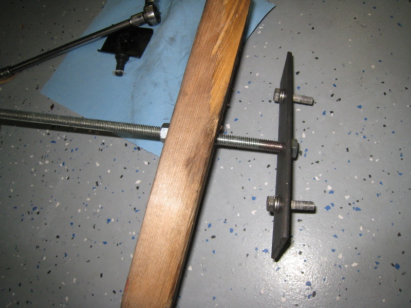

              A steady pressure puller works best to remove a stubborn pump housing.
              Remove nozzels. Place a 2x4 across the back of the hull with two holes that align with two of the nozzel bolt holes in the jetpump. Screw two pieces of 8mm allthread into the two nozzel bolt holes and extending out of the 2x4. Place a flat washer and 8mm nut onto the allthread. Tighten the nuts against the 2x4 and it will pull your pump out of the boat.
              I assumed that you have allready removed any water and bailer hoses and the jetpump mounting nuts and washers.
              If the pump will not come out, it is stuck on the corrosion between the aluminum jetpump housing bolt holes and the 4 studs that are in the hull. This will not be a problem if you have a plastic jetpump housing.
              There are a few ways to try breaking the corrosion loose so the aluminum housing will come off of the studs. The 2x4 and the two allthread studs will be appling alot of pressure onto the pump housing to try to remove it. While you have this pressure applied, try tapping on the ears of the aluminum housing at the mounting holes to shake the corrosion loose. Use an extension rod with a hammer to do this. This may not work if the corrosion is bad enough, but it is worth a try.
              If there is enough thread left sticking out of the pump housing to get two nuts onto the studs, you can jamb the two nuts together and use them to unwind the studs from the hull. Be advised there are nuts on each stud on the backside, inside the hull that must be removed before you can unwind the 4 studs that the pump mounts onto.
              This method usually works when nothing else will pull the jetpump from the hull.
              Personally, I use a 2 inch wide x 1/2 inch thick steel rod instead of a 2x4 to go across the back of the hull, and have been doing this with this method for as long as there have been Sea Doo watercraft around to repair.

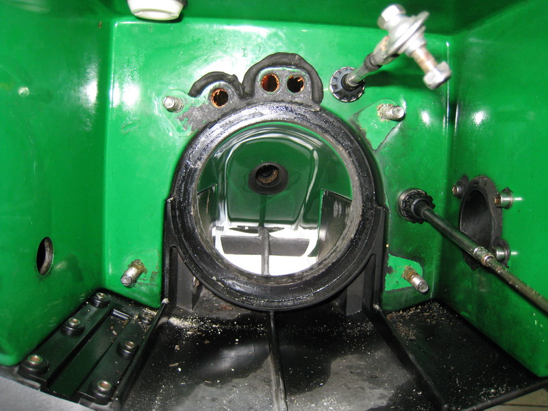

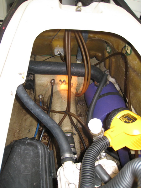

                  I'm pulling the pump in order to replace the wear ring on my '94 XP.
                  I am having trouble pulling the pump as well and will be building a puller as described above. Besides the two bailer lines and the one main water line, is there anything else inside the hull that needs to be disconnected?
                  Thanks!
                    Re: 94 Seado SPX Pump Removal

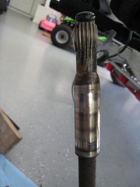

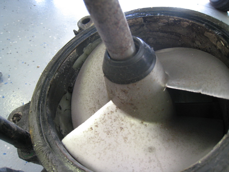

                    Got it, just the three lines to remove inside the hull. I built a puller and it was smooth sailing from there. The wear ring looks hammered!
                    Does the splined shaft look okay? Looks like it could use some grease for sure.
                    what else should I be replacing while I'm in here?
                      Driveshaft looks fine... That wear ring is toast!!! When's the last time you changed / inspected the pump oil?? You will have to do that to replace the wear ring anyhow.
